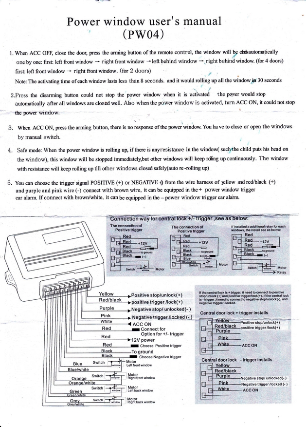

mariosant Posted August 11, 2017 Share Posted August 11, 2017 Hi everyone, I would like a little help. I want to install to my little frog (Micra K12) automatic power window close via cental lock without alarm. I messed up a little bit with the wires. Can someone tell me which wires i must connect ??? Thank you in advance Link to comment Share on other sites More sharing options...
Trevor Posted August 14, 2017 Share Posted August 14, 2017 Hi...welcome to the Forum I would start with the power and earth connections and know that the unit powers up before connecting to the windows independently. The diagram is quite simple to follow but I would enlist the services of an auto electrician if you do not have the skills or equipment to carry out the job as this could result in damage to the vehicle electrical system. Let us know how you get on with it Cheers Trevor Link to comment Share on other sites More sharing options...
