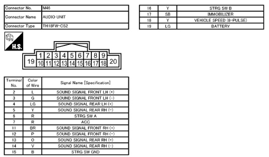

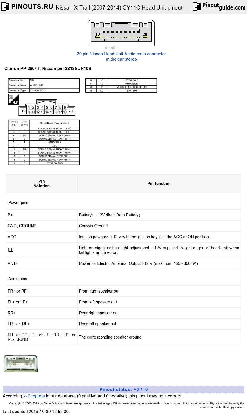

Hi all. New member here. Trying to fit an android headunit to replace malfunctioning Clarion CY11C unit on my X-Trail 2008. Unfortunately I was unable to source a wiring harness for the existing stereo so I cut the wires to do it old school. Tragically the pinout that is available on pinoutguide.com is incorrect so I'm stuck fast! Anyone have access the the correct wiring diagram please?

Here's a couple of diagrams but you would need to verify they are correct for your vehicle.
