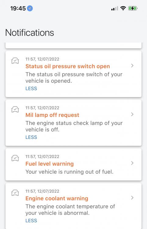

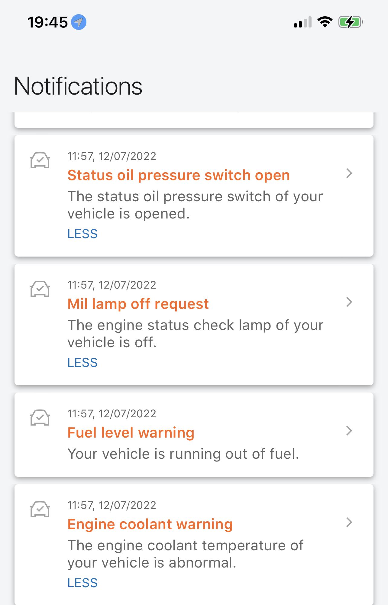

Herbiedax14 Posted July 12, 2022 Share Posted July 12, 2022 Hi, I have a Qashqai that is a month old and downloaded the Nissan Connect app. Today the app is coming up with faults but the car isn’t showing any issues. I have the car going in tomorrow for a diagnostic test but wondered if this is more likely to be an issue with the app. The fuel was low but I filled up and the app still notifies that the car is running out of fuel Quote Link to comment Share on other sites More sharing options...
Trevor Posted July 13, 2022 Share Posted July 13, 2022 It all sounds okay apart from the engine coolant warning but best be safe and have the codes read It could be that these are historic faults and just need the memory clearing Quote Link to comment Share on other sites More sharing options...
Herbiedax14 Posted July 13, 2022 Author Share Posted July 13, 2022 I have had the car checked and there are no issues. It appears to be a fault with the app and Nissan are looking into it. 1 Quote Link to comment Share on other sites More sharing options...
