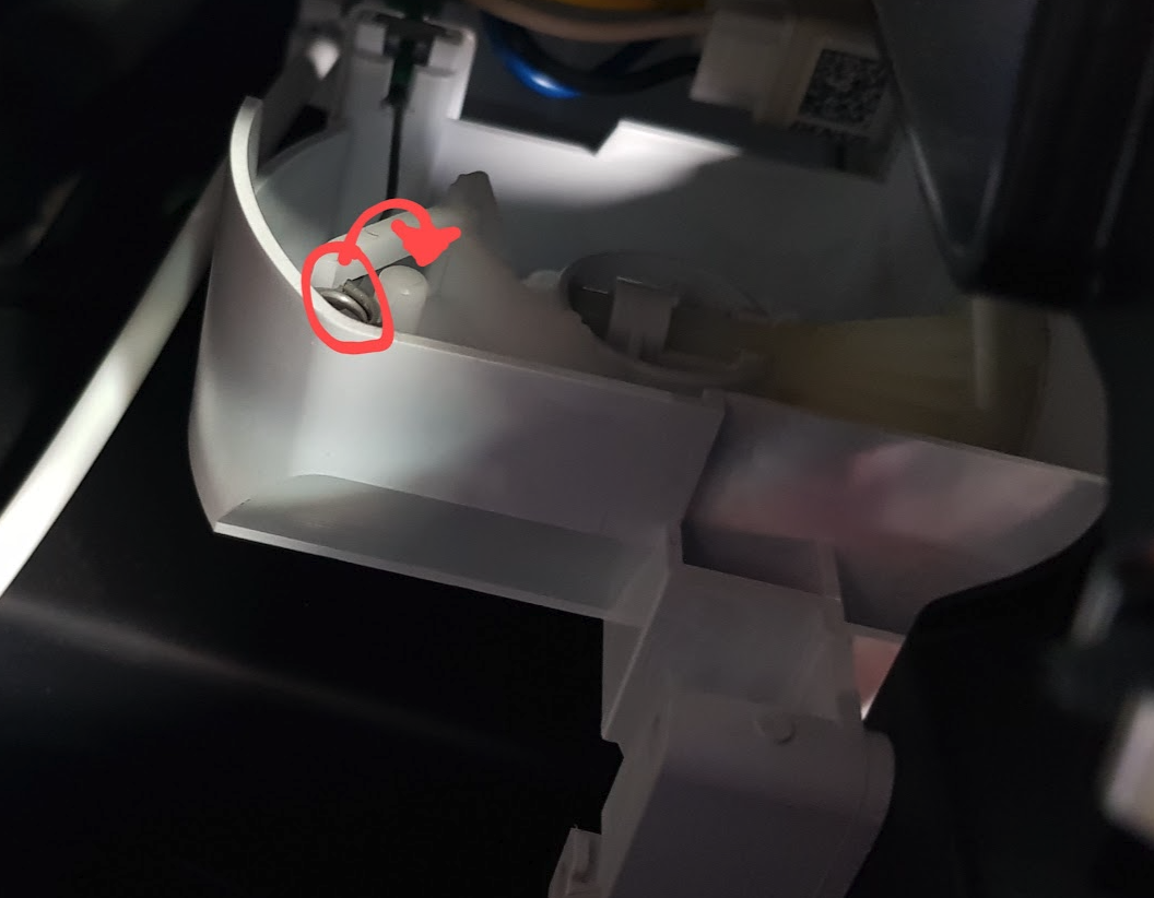

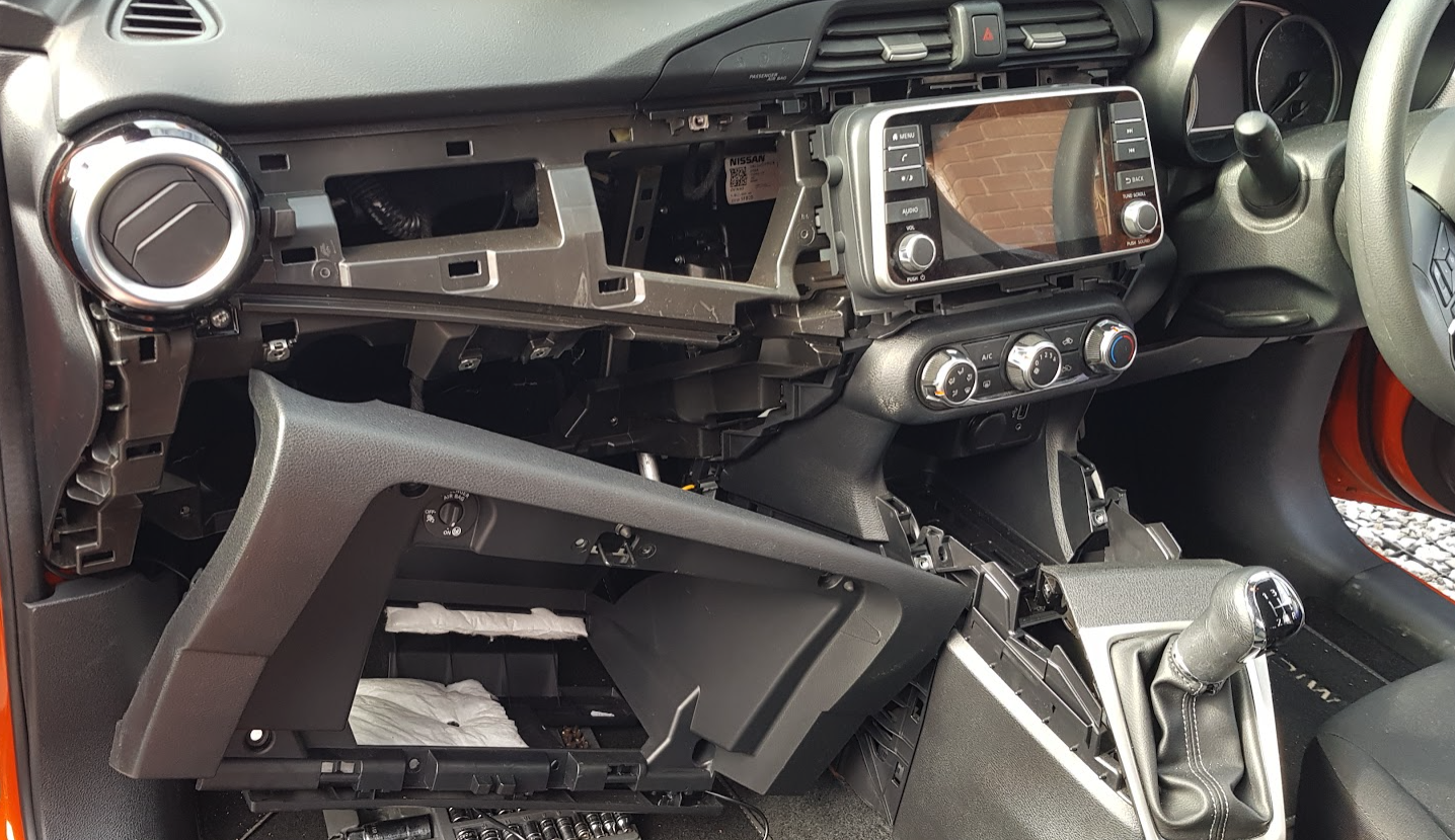

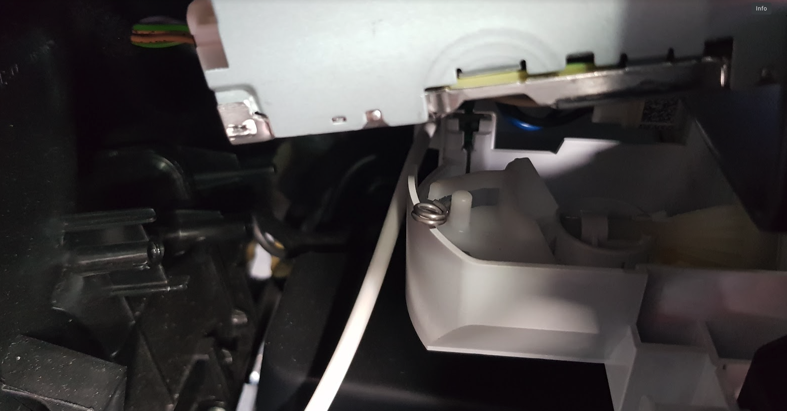

Tang02 Posted March 16, 2023 Author Share Posted March 16, 2023 This post was recognized by Trevor! Tang02 was awarded the badge 'Great Content' and 50 points. So, yes, indeed - it was the connecting wire that had popped off. Not really sure about how to fix I pretty much dismantled most of the dash - when in actual fact I now think I only needed to take the glove box and radio surround out. Quite easy really - all the trim pieces clip on so can be pulled out easy enough, then there were 8 ish screws holding the inner glove box in. Once thats out you can get to the back of the heater controls, where I managed to re-locate the loop end of the wire. Took a video of it once it was reconnected - although after this I did manage to bend the wire down a bit it wasn't as close to the top of the peg... I had actually ordered a new control panel from Ebay only £25), thinking something had snapped off inside it. Had I had to fit this the bottom console needs removing to give access to 2 screws holding the heater panel in - thankfully I didn't need to do this. https://www.ebay.co.uk/itm/254865205686. 1 Link to comment Share on other sites More sharing options...
