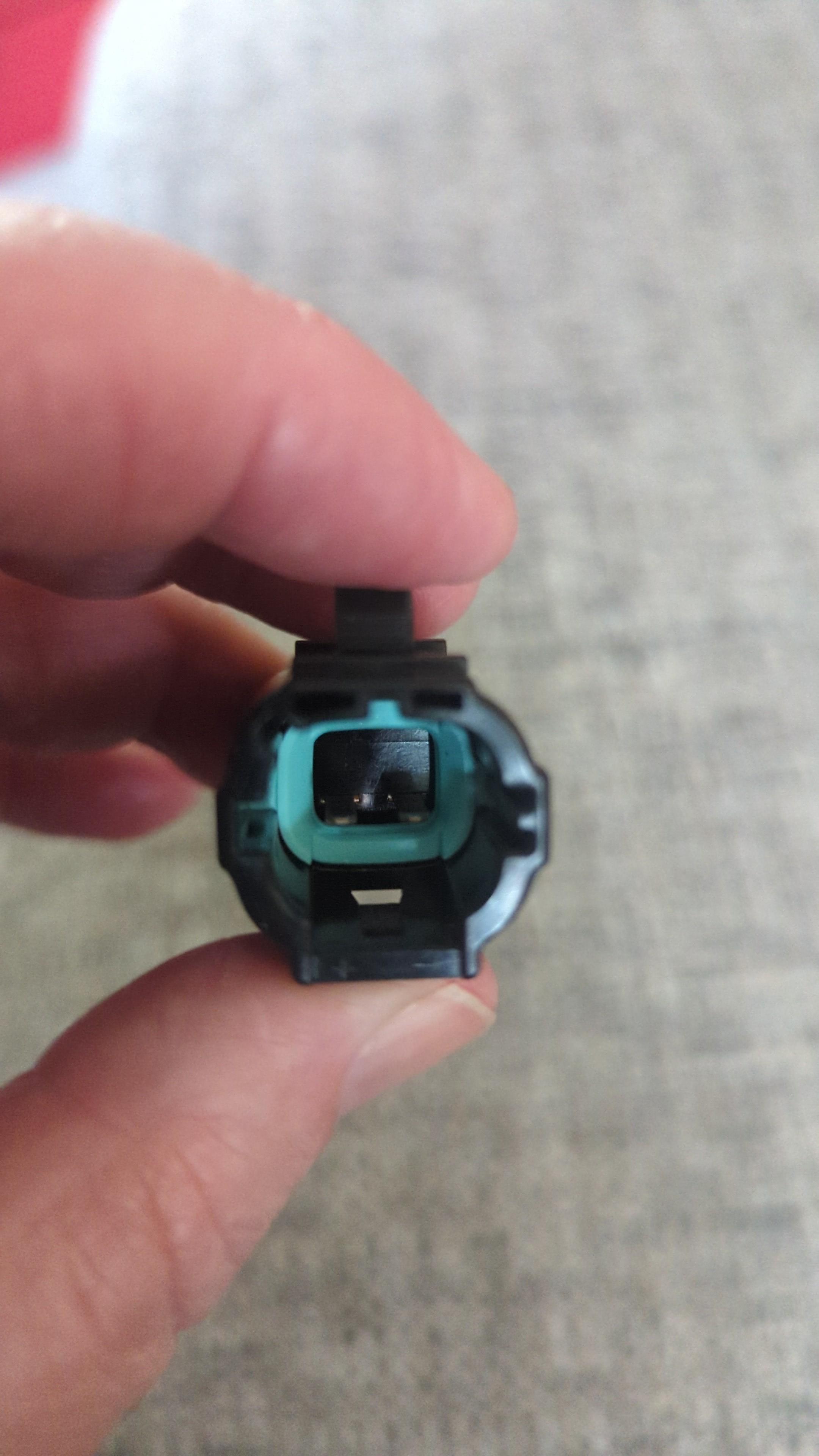

Mike c Posted January 20, 2024 Posted January 20, 2024 Hi all, first post xtrail t32 xtronic 66 reg 1.5 dci. Can some one accurately place where the sensor is? Default setting -40c. Looking at front of car in front of radiator 2 wires,,red, blue, very thin not attached to anything coming out of loom .could these be attached to sensor
Mike c Posted June 12, 2024 Author Posted June 12, 2024 Have finally purchased sensor.but it does not come with fitting to connect to wiring. Cannot find a suitable connector ! Help
Mike c Posted June 19, 2024 Author Posted June 19, 2024 Wonderful son managed to fix this to front xmember and attach wires! Air conditioning working nice and cold 1
Trevor Posted June 26, 2024 Posted June 26, 2024 Glad you found (or at least your son did) the location. Usually Air Temp Sensors are in behind the front bumper area so not too far away from that then 1
